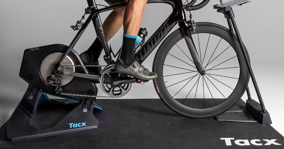

Nowadays, a lot of pedal-based power meters and select indoor trainers such as the Tacx® NEO 2 Smart Trainer can tell you just how much force you’re applying and in what direction force is applied. That lets us see how even the most experienced cyclists and pros apply their force. Based on this, we indeed see that pros apply their force better in the tangential direction than less experienced riders. By doing so, the pros tend to have fewer dead spots in their transitions from the upstroke to the downstroke and vice versa. Also, the pros never — unless they find themselves on a very steep climb with an extremely low RPM — pull their pedal. Instead, they actively unload the pedal, so the other leg doesn’t have to push against the weight of the passive leg.

However, that doesn’t mean that feedback isn’t useful. In fact, it can speed up the learning curve. For example, if you clearly see there is a dead spot in your upward transition phase and you know that your bike is properly set, you can try to actively push the pedal backwards. By doing so, the body learns there is a better and more effective way of pedaling. You could also try leg drills. Click one foot out of the pedal and use just one leg for about five minutes at the same RPM. Without the other leg helping, it becomes much more apparent when there isn’t a fluent transition phase.
One last very important thing that can help you achieve the perfect pedal stroke is to work on your core. If your core muscles are too weak, it is very difficult to maintain a stable and effective pedal stroke. You simply can’t fire a cannon out of a canoe. With these tips in mind, you will hopefully start to see your pedal stroke improving in the new Tacx software on your NEO 2 Smart Trainer.
