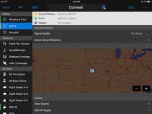

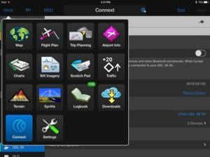

- Select the Connext icon from the ‘Home’ menu

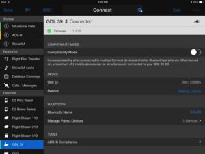

- Once the GDL 39 is connected via Bluetooth, select “GDL 39” on the left side ‘Devices’ menu, which should display a green bar on the far left indicating the unit is properly connected.

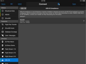

- Toward the bottom center, select “ADS-B Compliance” under the ‘Tools’ section.

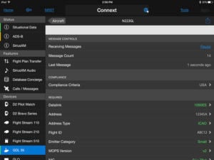

- All aircraft the GDL 39 “sees” will be listed here. In this example, N222GL is listed, showing its 1090ES Out – select this for additional info.
- If the aircraft’s ADS-B Out setup is good, the text will appear green. If the text appears red, the ADS-B Out setup requires additional troubleshooting.
