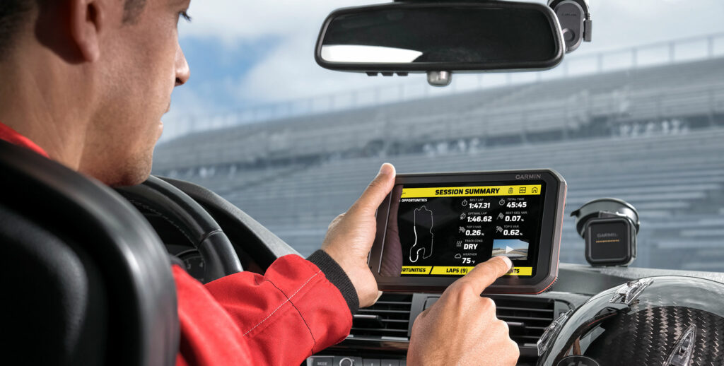

Of course, the line you drive through corners is critical, and there are times when you’ll actually “stumble” onto the optimum line. This is one of my favorite aspects of how the Garmin Catalyst™ coaches you, as it immediately recognizes when you find a faster path and gives you feedback so you’ll drive that line more consistently.

Part of human nature is that we tend to repeat what we’re rewarded for, and that’s a key component of the Garmin Catalyst*: it’ll actually give you confirming feedback — in real time — each time you do something that leads to gaining that little bit of lap time. In fact, you’ll begin to crave the message “New best.” Yes, that’s what the audio coaching tells you when you’ve just put together your braking, cornering and acceleration through a section of track better than ever before.
